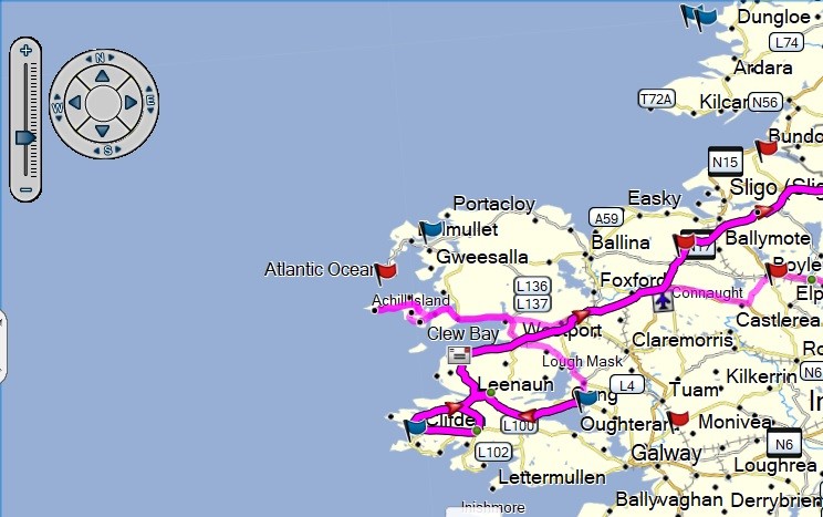

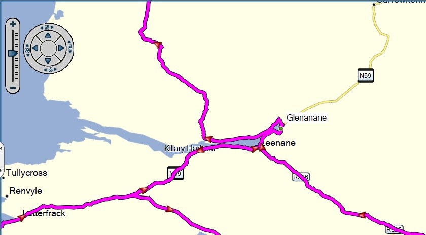

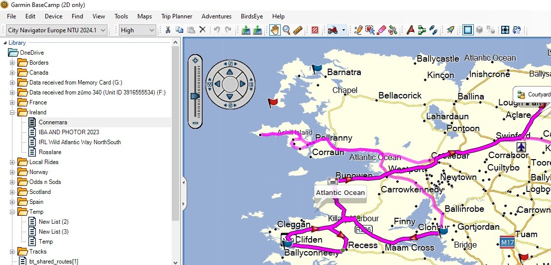

Its not just me then. I was using this route to come back home from Connemara on Wednesday. Because of time constraints I decided to cut off the loop going to Clifden. (this was a route doctored to be saved using the java script) I stopped at Leenaun to delete the two waypoints on this loop and set off. It tried to then loop me back to a waypoint created near Cong Co Mayo. I stopped and started the route again using nearest entry point :roll: and the route behaved all the way back to Belfast. Still persisting with this thing even though I still have a Nav IV Zumo340, Zumo390 and Streetpilot 2610....but then I am a masochist :D
Cong is the blue flag near to Clonbur / Gortjordan on the map ?
I can see the Blue flag and the green disc that you would have wanted to skip - and you did this around the location of the green dot next to the word 'Recess' on the map. It took me ages to find Leenaun on the map - that is because Garmin have spelled it Leenane !
Ok. I may be wrong - but It looks from the Basecamp route that The blue flag at Cong would be near to the start of the route ?
It also looks as though you didn't pass through it - or the XT didn't think that you had passed through it. In that case, it will always be wanting to take you back there.
If the XT isn't behaving as you think it should, it is worthwhile pressing the skip button, to see which point it is heading for next. If it is something that is behind you - agreeing to skip will clear that problem. Not passing throught he start point is a very common issue ever since the 590 and 595 and the related 39x and 34x were introduced. You MUST pass through the Via points. It is particularly common with shared group rides. Everyone with the same route congretgated arounfd the same start point. When some of the riders set off, they will have been in front to the start - and the satnav will spend the rest of the ride trying to get them to go back to it - even thought he screen shows the magenta line after the start plotting the route ahead.
It is for this reason that I always suggest placing the start point well away from the start. Eg if I am in the centre of a town or a city that had a ring road, my start point will be on the road that I want to take after I have escaped the ring of traffic surrounding the town. That way, if there are detours, road closures, trips for food, for petrol - whatever - the Zumo will keep recalculating a way to that first point - and pick up the route from there.
This has nothing to do witht he RUT behaviour or the alteration of the byte in the TRIP file. It is how the modern Zumos behave, and it is logical. Many people do not realise what is happening though.

Ill give it the benefit of the doubt as my Starting point was a little too close to Cross Co Mayo my starting point. If you want to see something even more weird name changes with zoom level on basecamp :lol: Lovely area mind :)
Leenaun, aka Leenane, I find it hard to believe that Garmin would have intentionally used zoom level to show both although I am routinely surprised at the things that appear and disappear as zoom level changes.
From Google Maps Quick facts: "Leenaun, also Leenane, is a village and 1,845 acre townland in County Galway, Ireland, on the southern shore of Killary Harbour and the northern edge of Connemara."
