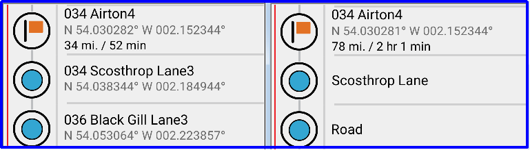

Route Point Names

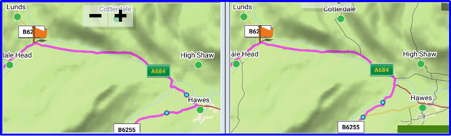

The Route list show the same route - Imported from Basecamp (left) and After Route has synchronised (right) Shaping point names are changed.
Changed Route Over-ruling Shaping Points (Hawes)
The original route on the left is unmodified - with BT disabled, it cannot synchronise. Note the two shaping points located to force the route not to take a tiny back road that avoids the junction in Hawes.
On the right, the same route after synchronosation has taken place. The original (yellow) main road towards Hawes is visible, and the route takes the tiny back road. Now with two different shaping points to force it to do so.

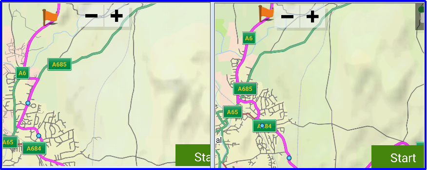

Changed Route Over-ruling Shaping Points (Kendal)
The original route on the left is unmodified - BT is disconnected, so the Tread App cannot synch. The two points were placed to force the route to take an arc through an estate to avoid the busy one way system around Kendal, and then to force it to turn right (NNE) along the A685. Turning left would force a very busy right hand turn wiht poor visibility onto the A6. The route joins the A6 by turning left (W) a little way up the road. Much safer.
The modified route - after synchronisation - has changed. The route still goes through the estate, but there is no shaping point to make it do so. After the curved road at the estate, the route turns left an then immediately right onto the A6 - the very manoeuvre that I was hoping to avoid.
The shaping points seem to have been moved onto the main A684 road - and are completely unnecessary there.

Route Point Names

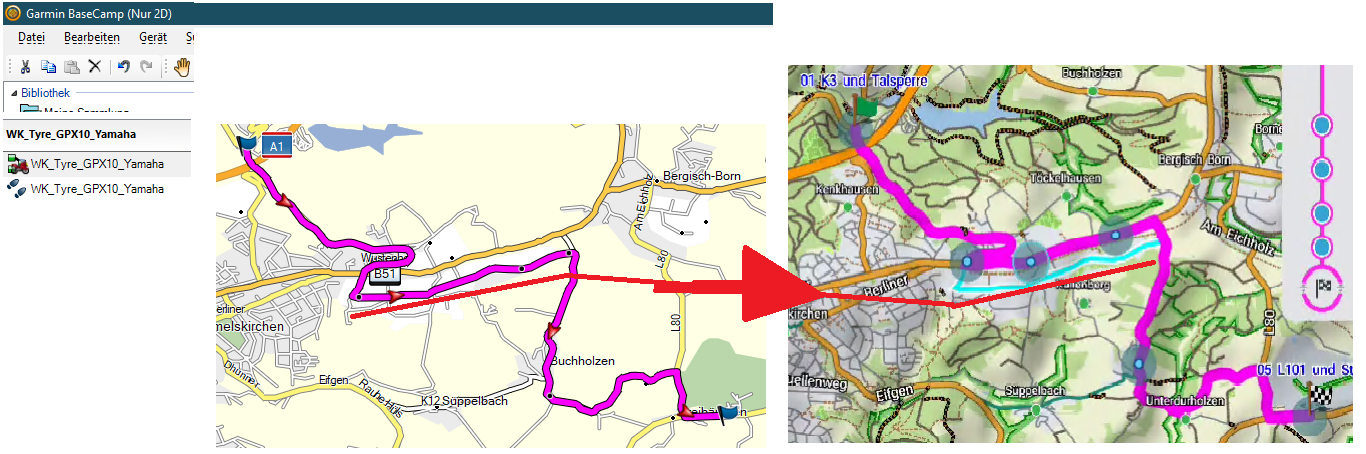

The Tread APP changes planned points!
I have a small example:
1st. Route and track from Basecamp.
2nd. Without Zumo XT2 only imported into the Tread app.
3rd. 1st result: The sharpening points are changed and moved after the import into the In Tread App.
4th. Attempts to manually place a sharpening point so that the route also follows the desired track.
5th. The Tread app also changes this point so quickly that you hardly notice it (see video in attached 20240925_220545.zip)
I find this behavior unacceptable!
If I plan a route (in this example past a Yamaha dealer without necessarily having to stop there) then the XT2 should also take me there.

Also from earlier tests, importing the route into the Tread app - well Tread takes many liberties.....
I've still got some little anomalies to sort out and pin down as I am still getting slightly inconsistent results. But this is more useful to me.

@jfheath Well that's interesting. Inconsistent results adds to the puzzle. Did you have Tread connected to the Explore database or was this recent test syncing to Tread only?
Re: Poll : Curious about the Zumo XT2 ? Read on....
I like inconsistent results. It means I am getting close to isolating the result that I want !! (or I made a mistake).
