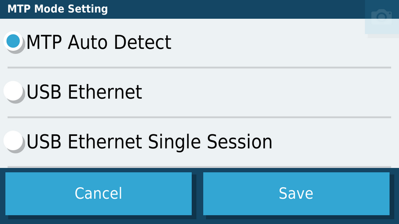

The Garmin XT sadly doesn't have mass storage mode (only MTP and something called USB ethernet, which I'm yet to find out what it is)
