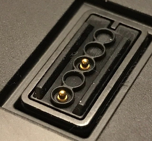

Can we assume that you have the power lead secured in the mount with the tiny screw - quite a few people don't?
Are you using the very latest lead as per this picture?
New Cable.jpeg (94.49 KiB) Viewed 4768 times

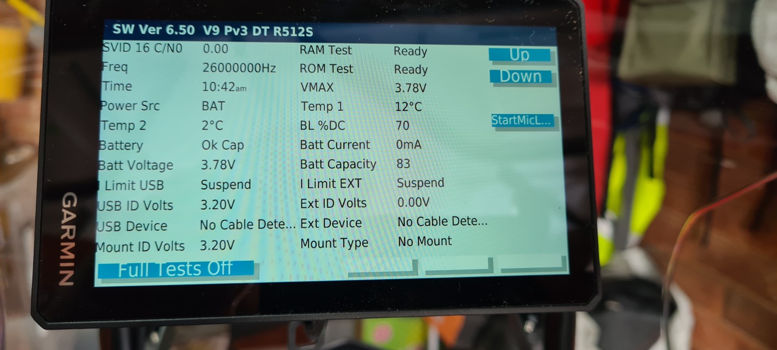

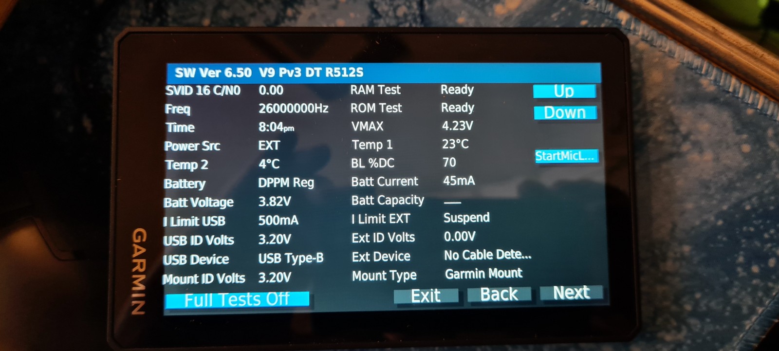

I also have a charging issue when connected to mount, it goes straight to battery mode. If I connect via USB it charges. The mount is wired to an ignition live connector and the 3rd pin on the mount is showing 5.14v when ignition on. I went into the diagnostic screen (see below) and see that when plugged in to a USB it says it's connected to the garmin mount which it wasn't it was my PC and shows that there is no USB cable detected. When connected to the mount it shows no connection whatsoever and uses battery. The only thing I've not been able to do is try it in another mount.
