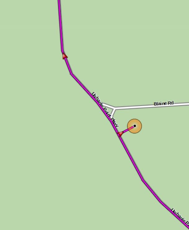

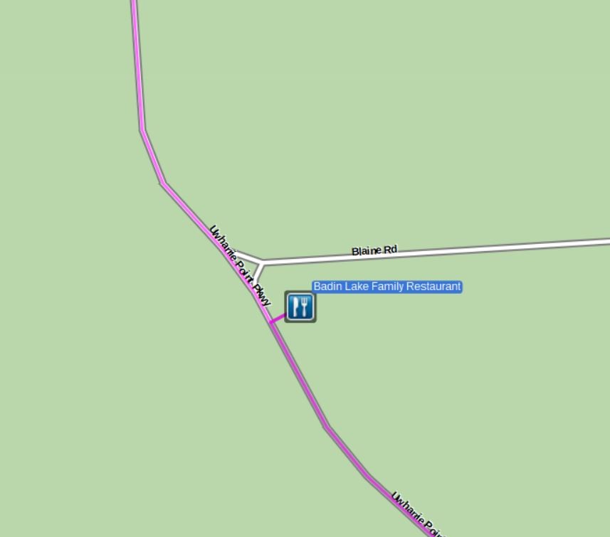

It doesn't need to be a new shaping point. I am just thinking about the ramifications of replacing via points with alerting points. Below is an example where I have replaced a lunch stop at the POI via point Badin Lake Family Restaurant with an alerting shaping point named Badin Lake Family Restaurant. The coordinates of this POI via point may not be off-road enough that the XT would force me to skip if I didn't pull in but usually they are. This problem is alleviated with the alerting shaping point. The XT will route me to it but won't care if I bypass it and continue on the route.
WP vs SP 3.JPG (26.55 KiB) Viewed 3998 times
WP vs SP 5.JPG (23.24 KiB) Viewed 3997 times

In my opinion and after my experiences - if you turn an shaping point to 'alert on arrival' you change the shaping point to a via point! You than MUST drive to that point or skip it it with the 'Skip' button, i've done this many times...
For example i use this when planning routes for both of us, my wife and myself - i know, that she can drive about 330km with her Street Triple and when we are on a route which is longer than that, i search for a gas station around 300km and set a shaping point just 500m before and turn 'alert on arrival' on by this point, just to 'not miss' the 'last' gas station for her. When riding, this point will be shown on the map as an orange flag and the approach will be signaled on the upper bar of the Zumo XT and by a tone when audio is enabled. This point behaves and already is a via point - it's not a Waypoint, as it doesn't be added to your 'Favorites'.
You can try this on the Zumo XT with a 'Simulation' just for proof...
Bye, Robert :)
