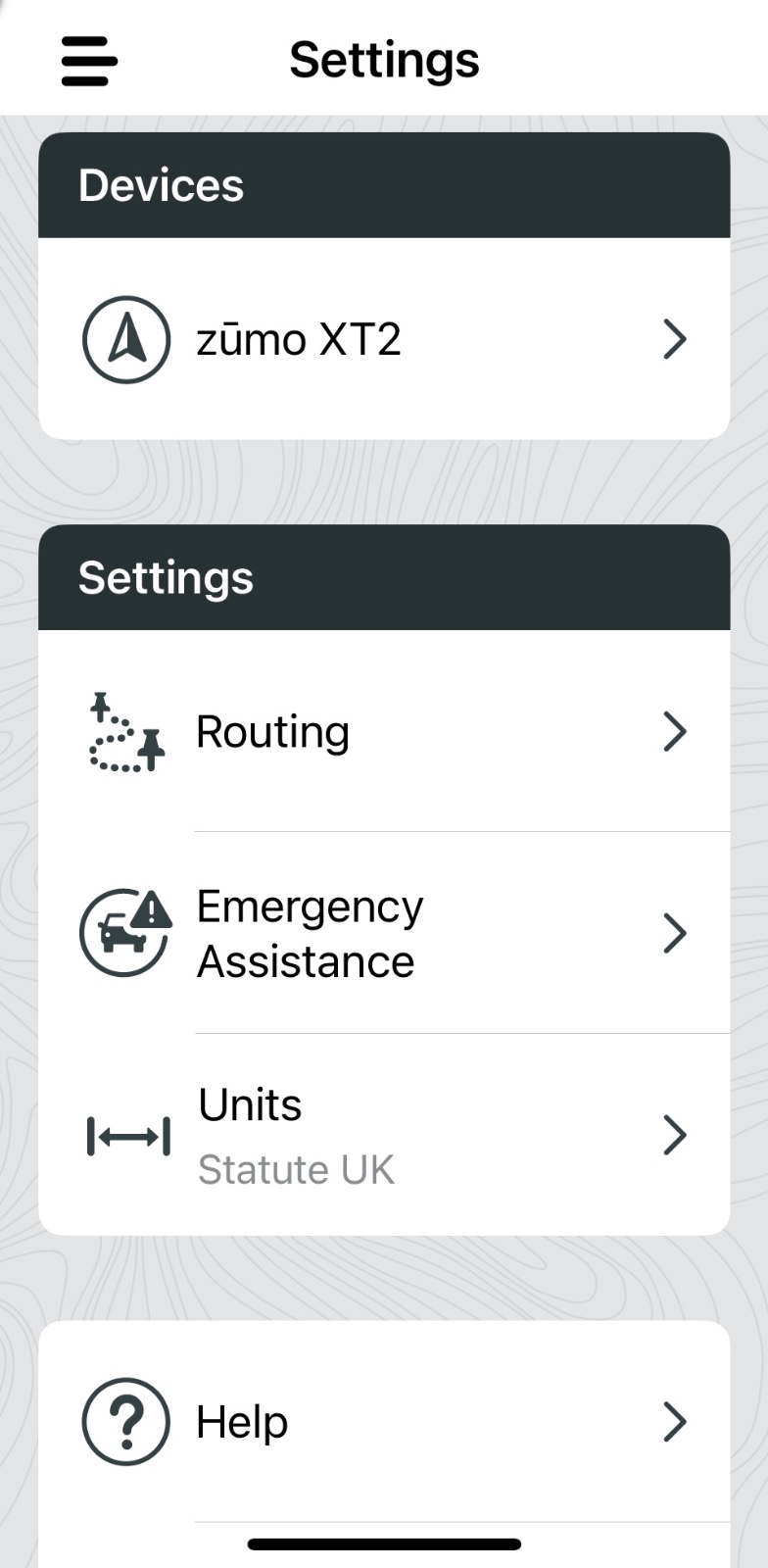

According to the user manual I should see smart notifications, txt messages etc, on my XT2 when it connected to Tread app on my iphone 15.
I always have Tread connected but I’ve never seen any text messages notifications on the XT2 screen.
Anyone know how to make smart notifications appear on the XT2, there’s no settings for smart notifications in the Tread app.
- IMG_0901.jpeg (138.93 KiB) Viewed 4565 times

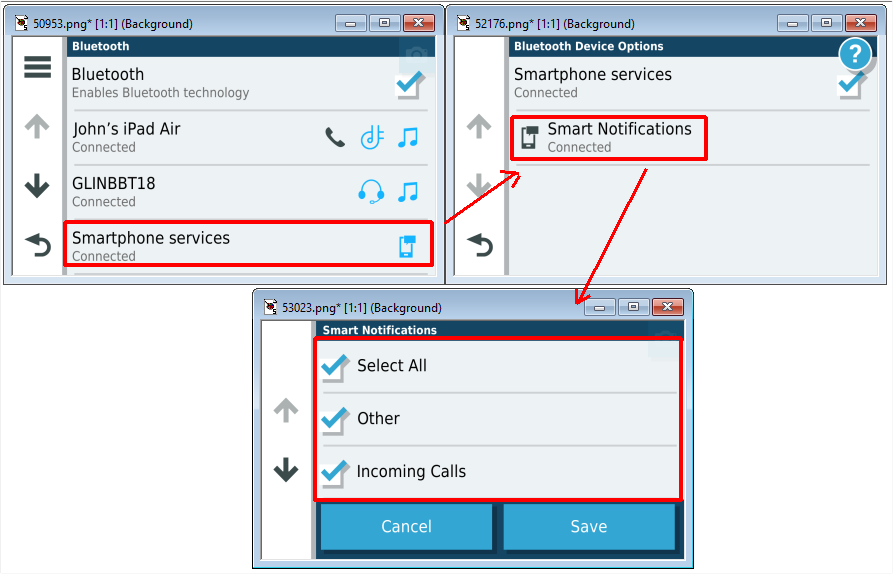

On the XT2 find what might be the equivalent of the XT's Bluetooth->Smartphone Services->Smart Notifications. Possibly in Settings->Phone->phone name ..... and scroll down

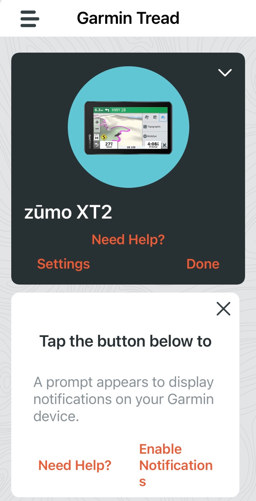

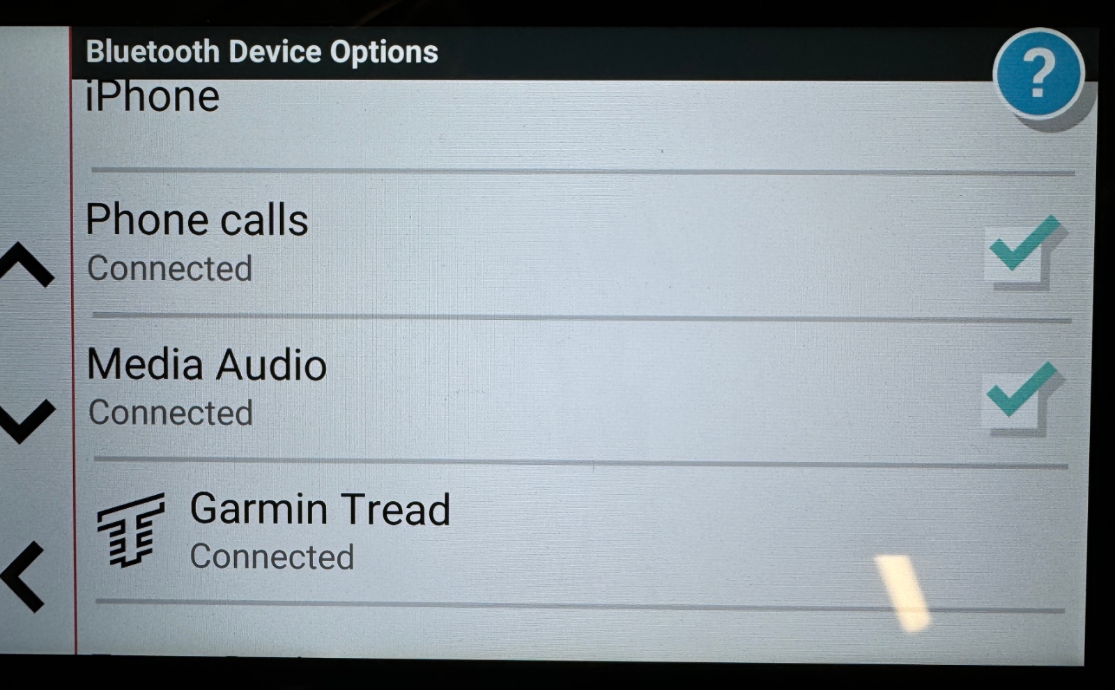

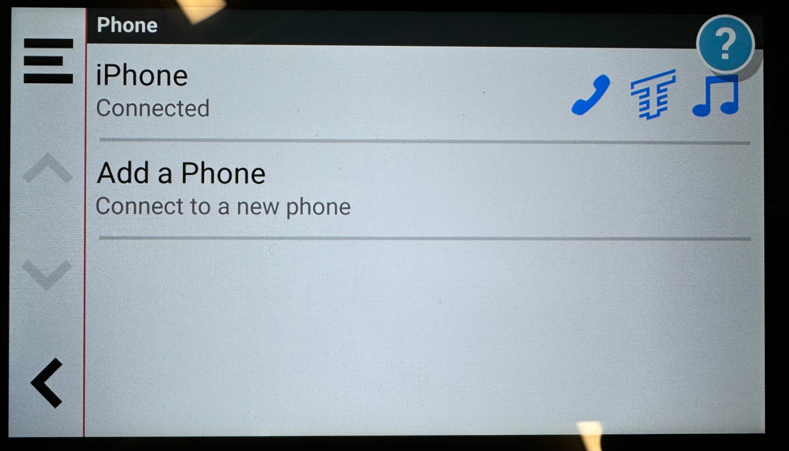

Thanks for the reply John. I’ve gone through every setting I can find, both on the XT2 and on the iphone Tread app.
On the XT2 phone settings it just says my iphone is connected for calls, media audio and the Tread app.
On the Tread app, theres a setting to enable smart notifications; when I select this it puts a pairing code on the XT2 which I press OK to confirm it matches the code displayed on the iphone. I also select “pair” on the phone. I followed this process when I originally set it up, but I’ve just done it again in the hope it refreshes something.
I’ve just ran another test, getting someone to send me a text message, but it still doesn’t give any notification on the XT2 screen.
It seems that the XT2 when used with an iphone cannot display text msg notifications.

I've just spent 30 minues trying to make my ipad look like a phone. I can do it with the XT and Drive, and checked the procedure with that and obtained a few screenshots.
I tried to do the same with the XT2 and failed. But the ipad isn't a phone so .
A few things that I did notice - I had to set up Tread again. I didn't need to install it and I didn't need to scan the bar code.
For both Drive and Tread I did need to unpair and forget about the XT2 on the ipad / phone
And I did need to forget about the phone on the XT2 - and start the pairing process again.
And then re-establish the BT connections. The phone still said it couldn't connect well after the XT2 has displayed the bluet tread icon to indicate that it was connected.
This section of the manual syas that it is possible and you get an icon alongside the phone to show that it is connected. Along withe the phone, music and Tread icons. That sounds very much like what I have seen on the iphone with Drive and the XT1
https://www8.garmin.com/manuals/webhelp ... E2294.html
This is was the XT looks like when the ipad (pretending to be an iphone) looks like when it is connected.
The list of 3 smart notifications shown - is actually about 3 times as long as that.
I hope someone who has an iphone is able to fill in the blanks if they see this post.
Nb - You may have to allow the Tread App to send notifications. I have to do that on the Android phone. I wouldn't know about the iphone.
