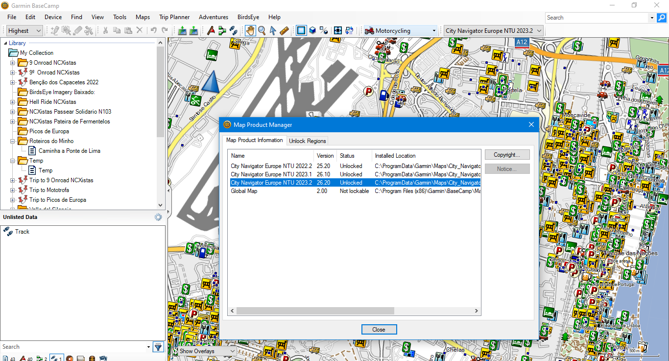

BINGO!!! :lol: :lol: :lol: PROBLEM SOLVED
I copied the 2 most recent .gma files to the PC using JaVaWa GMTK and it worked!
CN Europe 2023.2 unlocked and running!
Europe 2023.2 unlocked.PNG (723.71 KiB) Viewed 5353 times
I guess the map reinstall on the XT fixed something and provided the right codes. Despite GE map install on PC failing again, the JaVaWa GMTX solved it by placing these new codes.

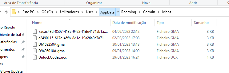

These were the codes on my PC before trying the map reinstall on Zumo XT:

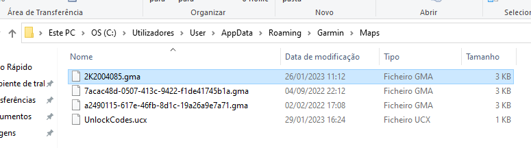

This is the same folder after map reinstall on Zumo XT, removing the highlighted .gma file provided by Garmin Support, and copying the two .gma files from Zumo XT with the help of JaVaWa GMTX:
codes final.PNG (27.81 KiB) Viewed 5349 times

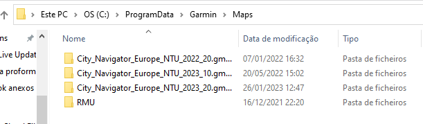

Anyways my mapset was already on the PC folder when using GMTK software:
The problem was map being locked and unusable.
