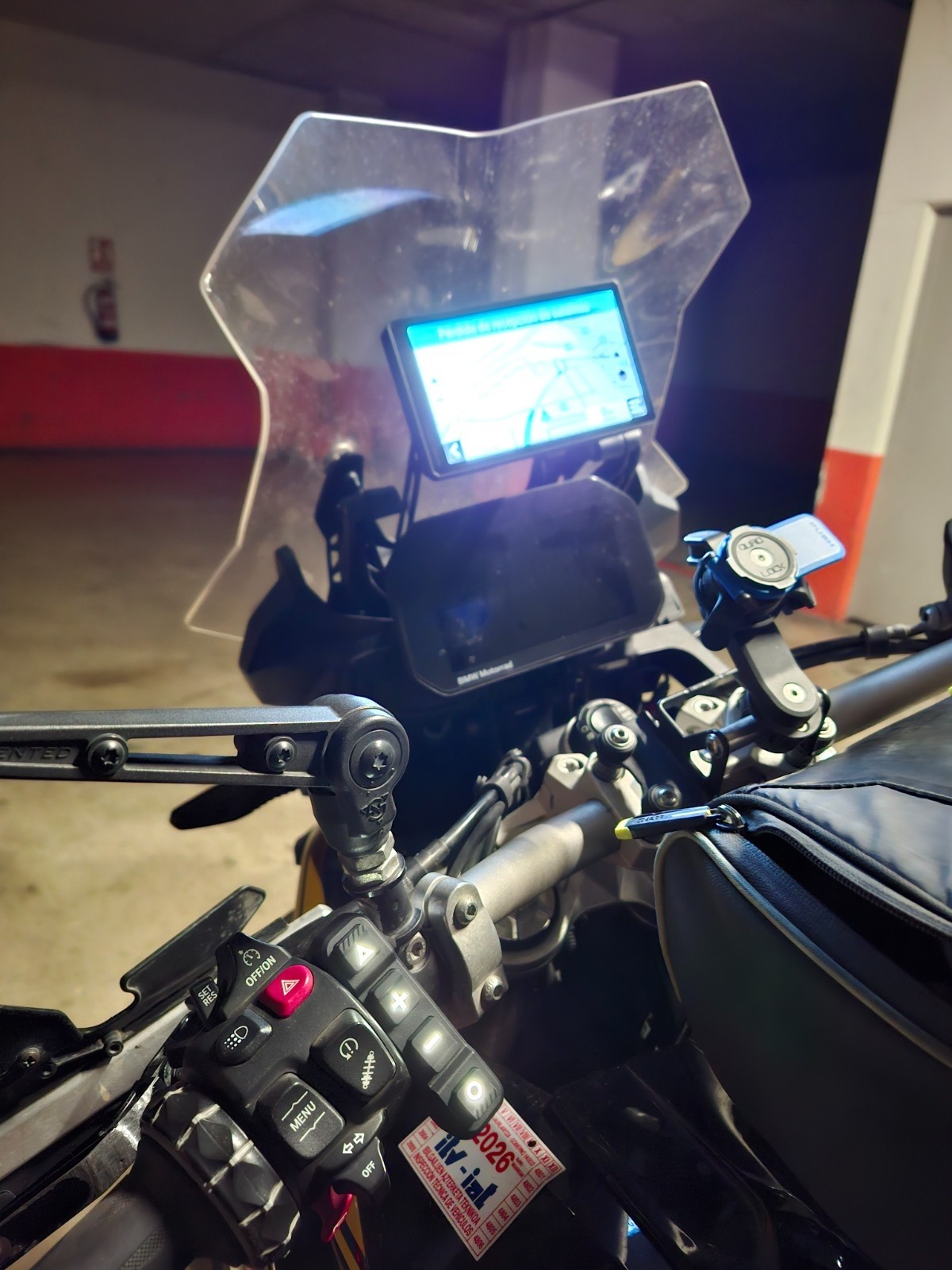

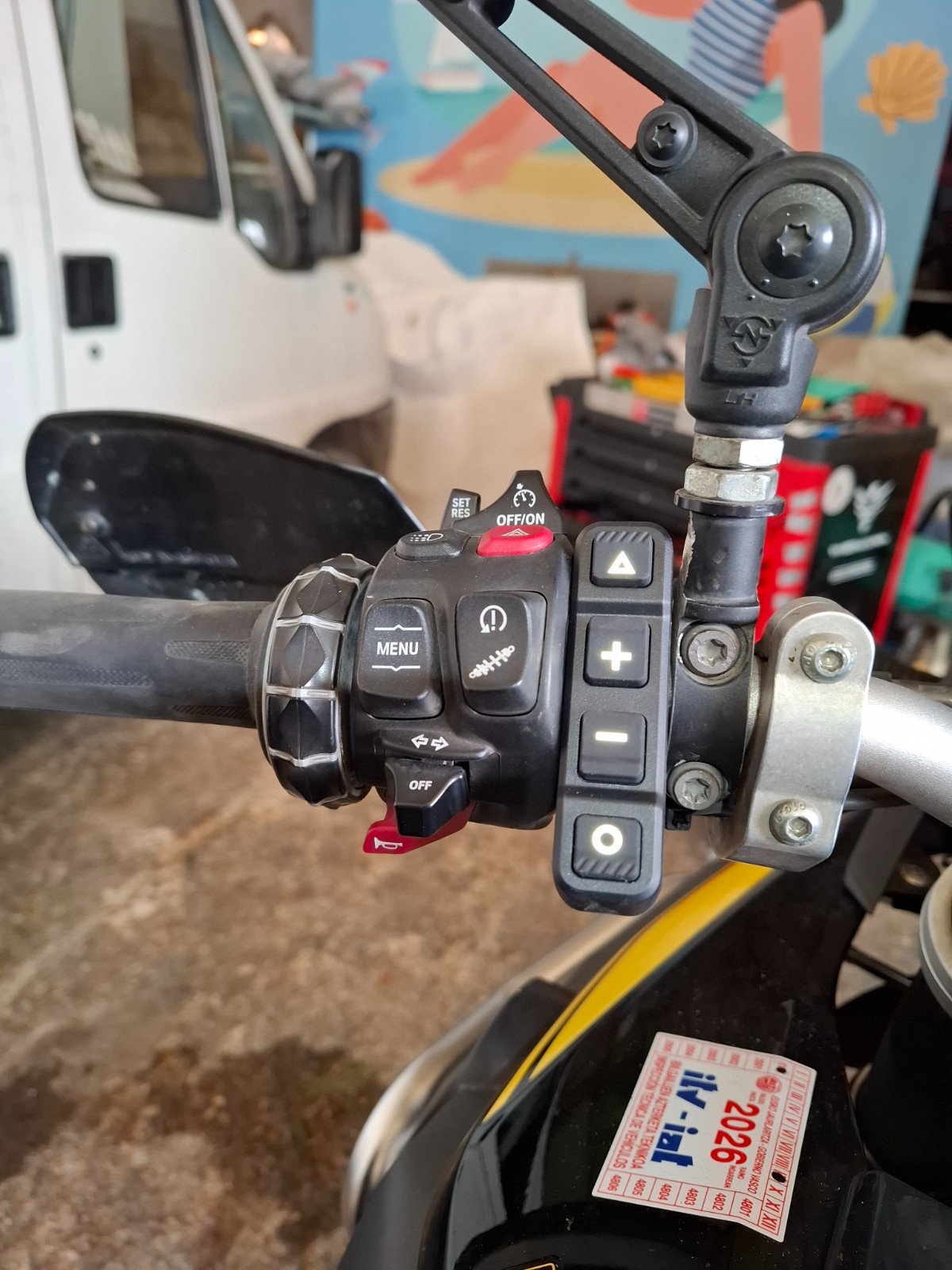

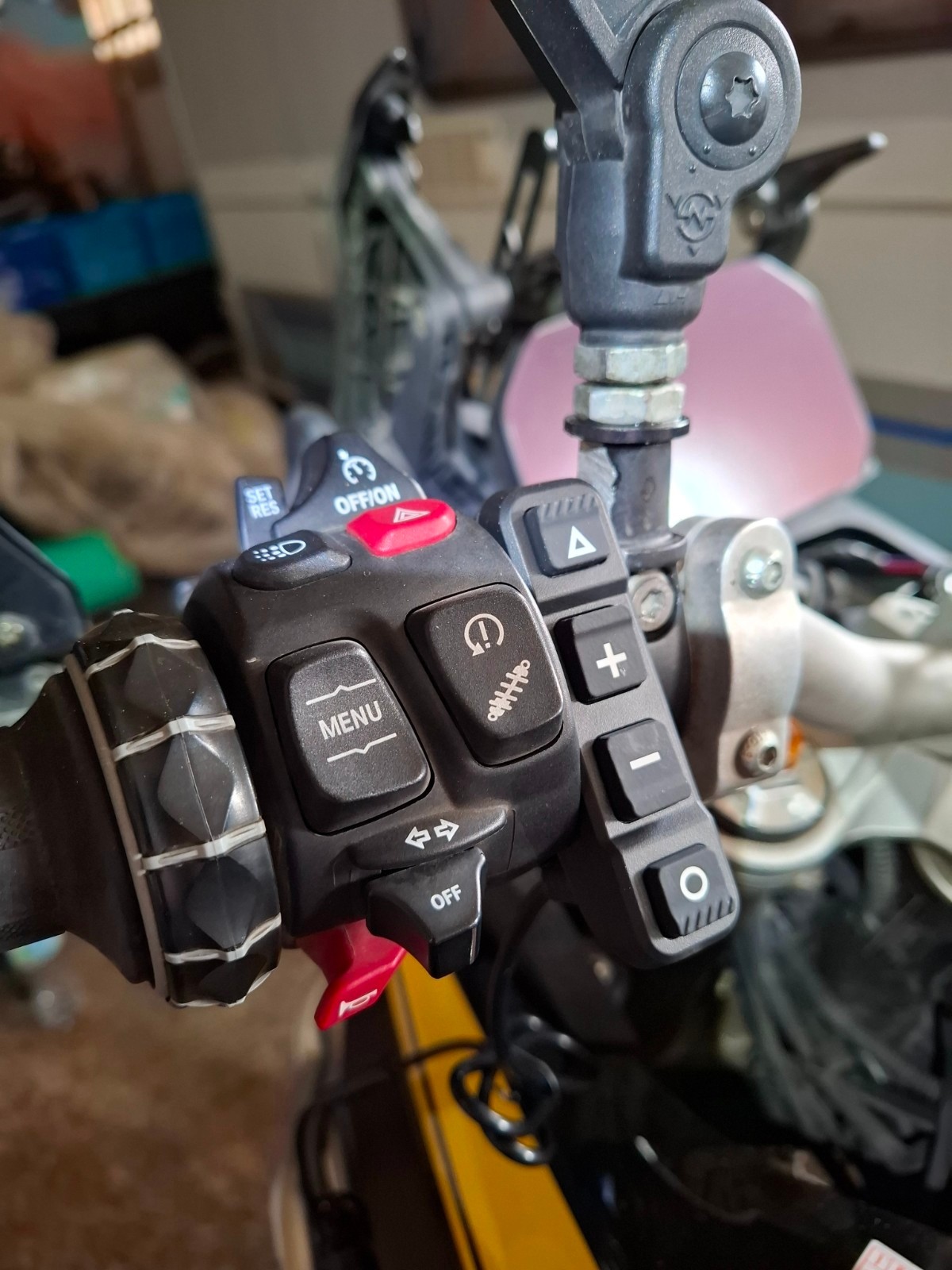

Playing, I have installed everything according to the scheme that was shared on the forum. Trying different options. The feel of the buttons is very good.

Thanks for posting those @turbo19 .
Please excuse me (ab)using my moderator privileges and copying the images to twist them through 90 deg).
It looks like a really good fit on your bars.
