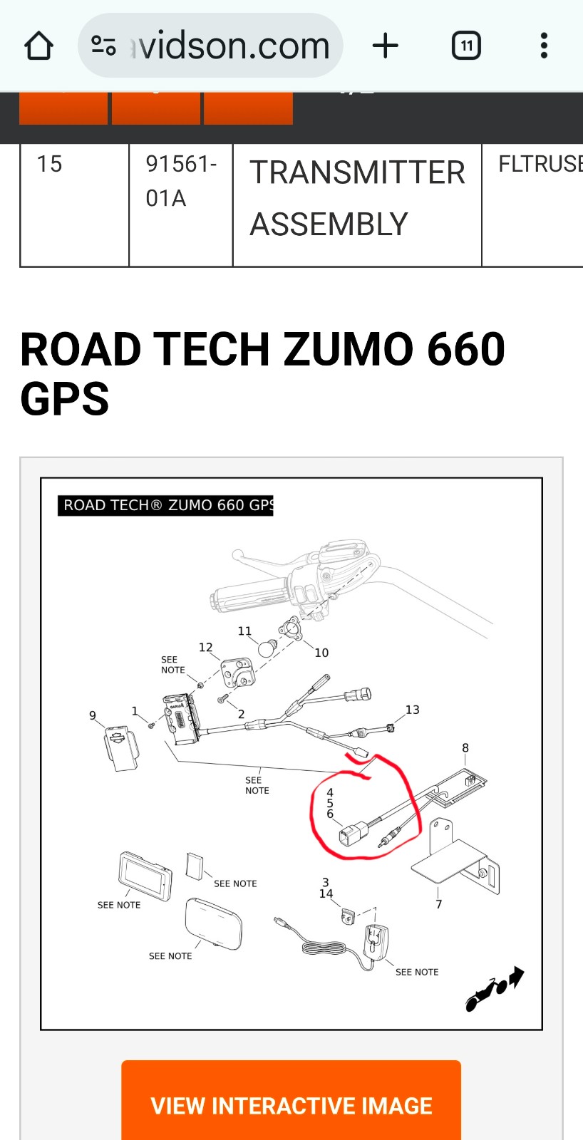

I currently have a Zumo Road Tech 660 mounted on my Harley Davidson. I'd like to upgrade to the Zumo XT and want to know if I can utilize the existing mount? The attached picture from the Road Tech Zumo mounting kit instructions looks like it will work. My understanding is that the bolt pattern is pretty much a standard, and since both units are Garmins, I thought it would work. Has anyone here tried this or have thoughts on the matter?

Part G in your drawing is what I am assuming you are calling the mount, not the Garmin Specific Cradle.
If so, then yes... All Garmin Mounts/Cradles utilize the standard AMPS Mounting Bolt Spacing, so the XT Cradle will bolt up to part G in your diagram.

Yes. Part G will stay mounted on the motorcycle fairing. I'll need to do a little rewiring, but sounds like it will work. Thanks for the feedback!

That HD part should have been called the AMPS Fairing Mount Adapter. They were selling the z660 at the time so they used that instead.
